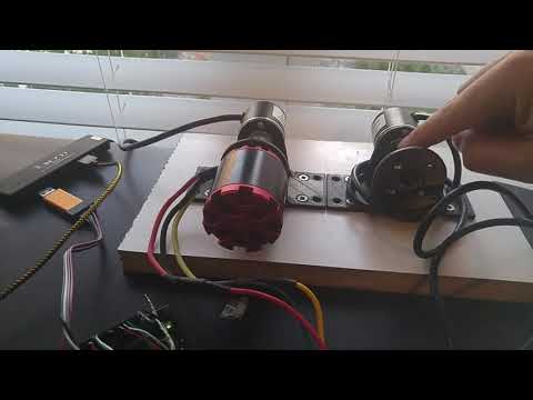

MIRROR = 7 (0x7)
Implements “electronic mirroring”.
This is like electronic camming, but you can only mirror exactly the movements of the other motor, according to a fixed ratio.
[![](http://img.youtube.com/vi/D4_vBtyVVzM/0.jpg)](http://www.youtube.com/watch?v=D4_vBtyVVzM “Example Mirroring Video”)
### Configuration Values * config.axis_to_mirror * config.mirror_ratio
### Valid Inputs * None. Inputs are taken directly from the other axis encoder estimates
### Valid Control modes * CONTROL_MODE_POSITION_CONTROL * CONTROL_MODE_VELOCITY_CONTROL * CONTROL_MODE_TORQUE_CONTROL
