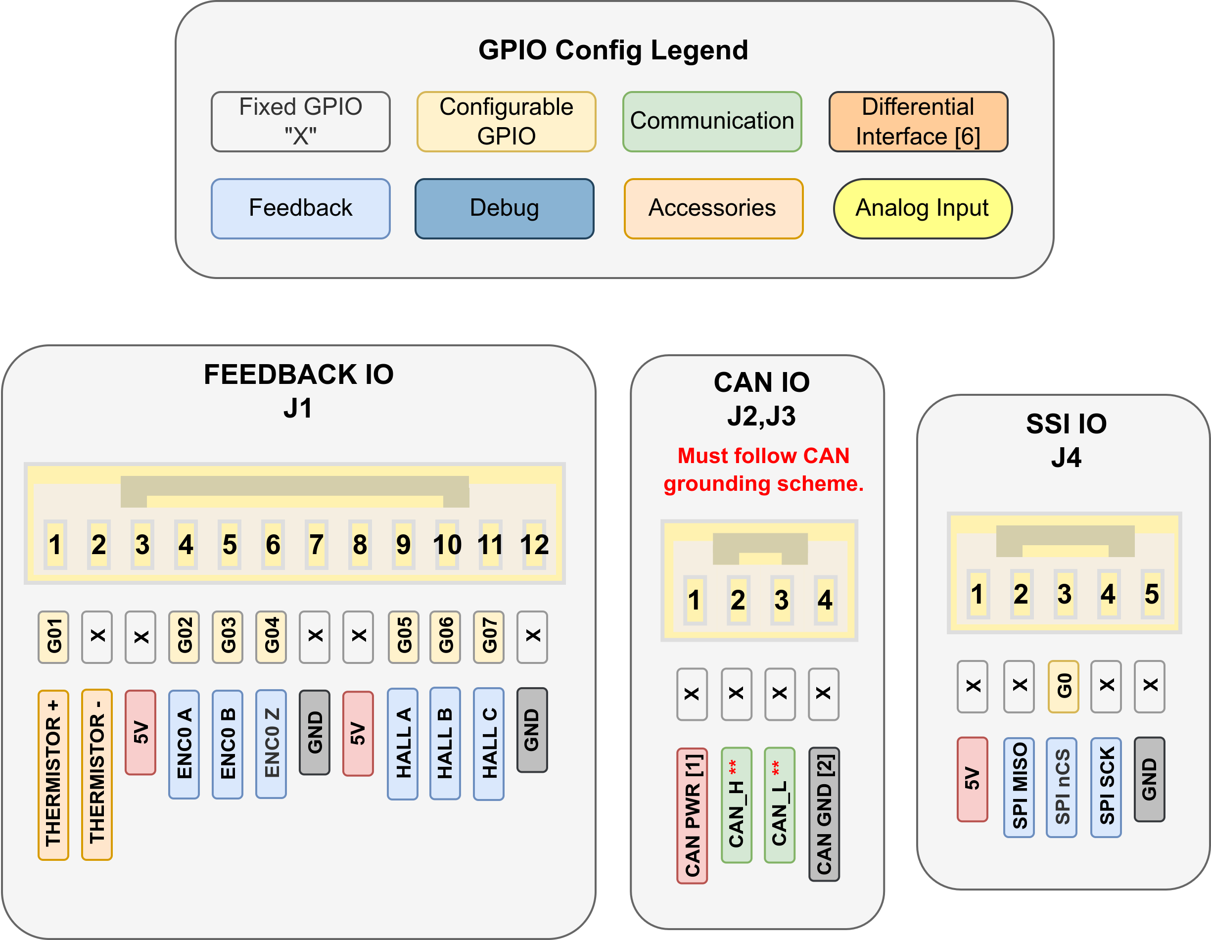

  1. Connect (screw terminals or solder) the motor phases to A/B/C (Pro, S1, Micro).
  2. If the motor has a thermistor, connect it to THERMISTOR+ and THERMISTOR- (Pro, S1, Micro).
  3. Solder the power supply cables onto the solder pads that are labelled +/-.
  4. If using an encoder, connect it to the corresponding I/O connector.
Note
Please see the datasheet pinout (Pro, S1, Micro) for important information about pin functionality and specifications.
../_images/pro_pinout.png
Click for full Pro datasheet pinout.
