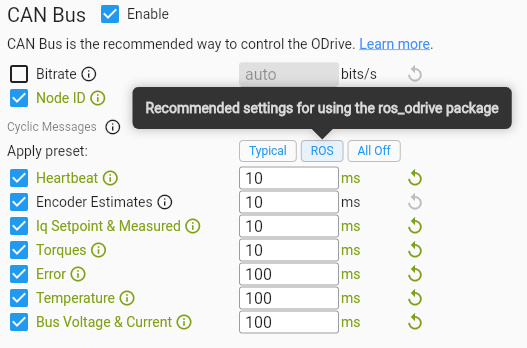

First, configure the ODrive such that it can spin a motor and communicate over CAN. This process is largely independent of ROS2 and described in more detail in these guides:
Using the Web GUI (Configuration > Interfaces), assign a unique node ID to each ODrive on the bus and enable feedback messages by clicking on the “ROS” preset in the CAN configuration section:
../_images/gui-can-config-ros.png
Verify these messages are working properly with:
  • candump can0 -xct z -n 10, or
  • python3 -m can.viewer -c "can0" -i "socketcan".
