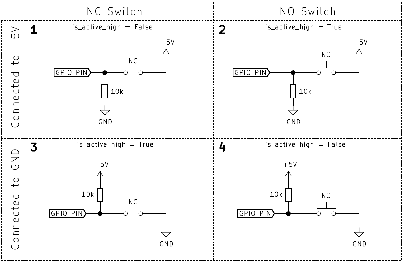

GPIO Configuration
If using a switch without a built-in pull-up or pull-down resistor, you need to either add an external pull-up/pull-down resistor, or set the GPIO mode to DIGITAL_PULL_UP or DIGITAL_PULL_DOWN.
Assuming your endstop is connected to GPIO X:
  • Configuration 1, 2: <odrv>.config.gpioX_mode = GPIO_MODE_DIGITAL_PULL_DOWN
  • Configuration 3, 4: <odrv>.config.gpioX_mode = GPIO_MODE_DIGITAL_PULL_UP
Endstop figures, snowing NC/NO orientation, and cross-connection to where the switch is connected (to GND or +5V rail)
Note
Most ODrive pins have built-in pull-ups, so wiring your endstop as per configurations 3 and 4 is typically recommended, and use of DIGITAL_PULL_UP is redundant. See the “GPIO Properties” section of your ODrive’s datasheet for more information.
Warning
All pins in the ISOLATED IO domain on ODrive S1 and ODrive Pro do not support DIGITAL_PULL_UP or DIGITAL_PULL_DOWN; an external pull-up or pull-down resistor is required.
