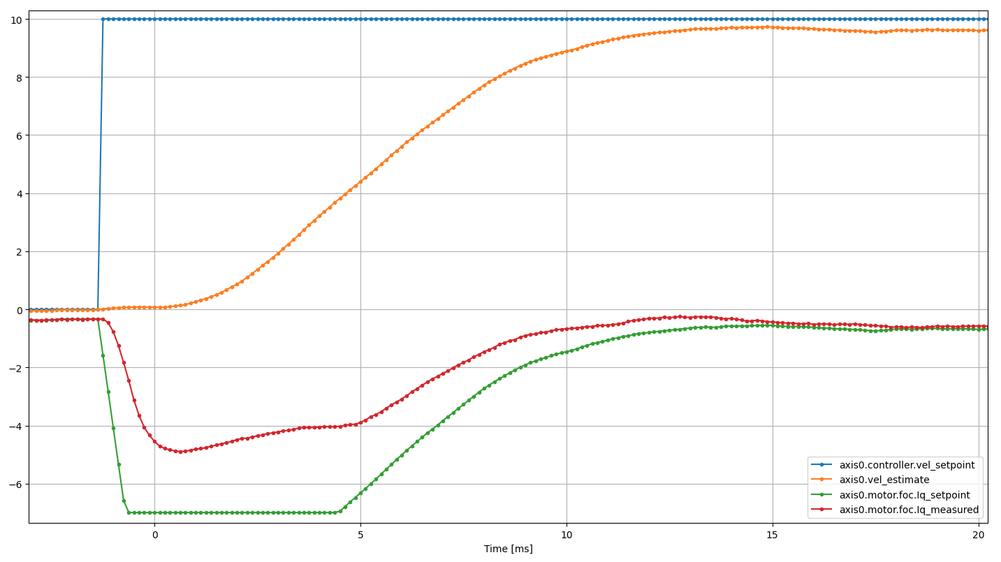

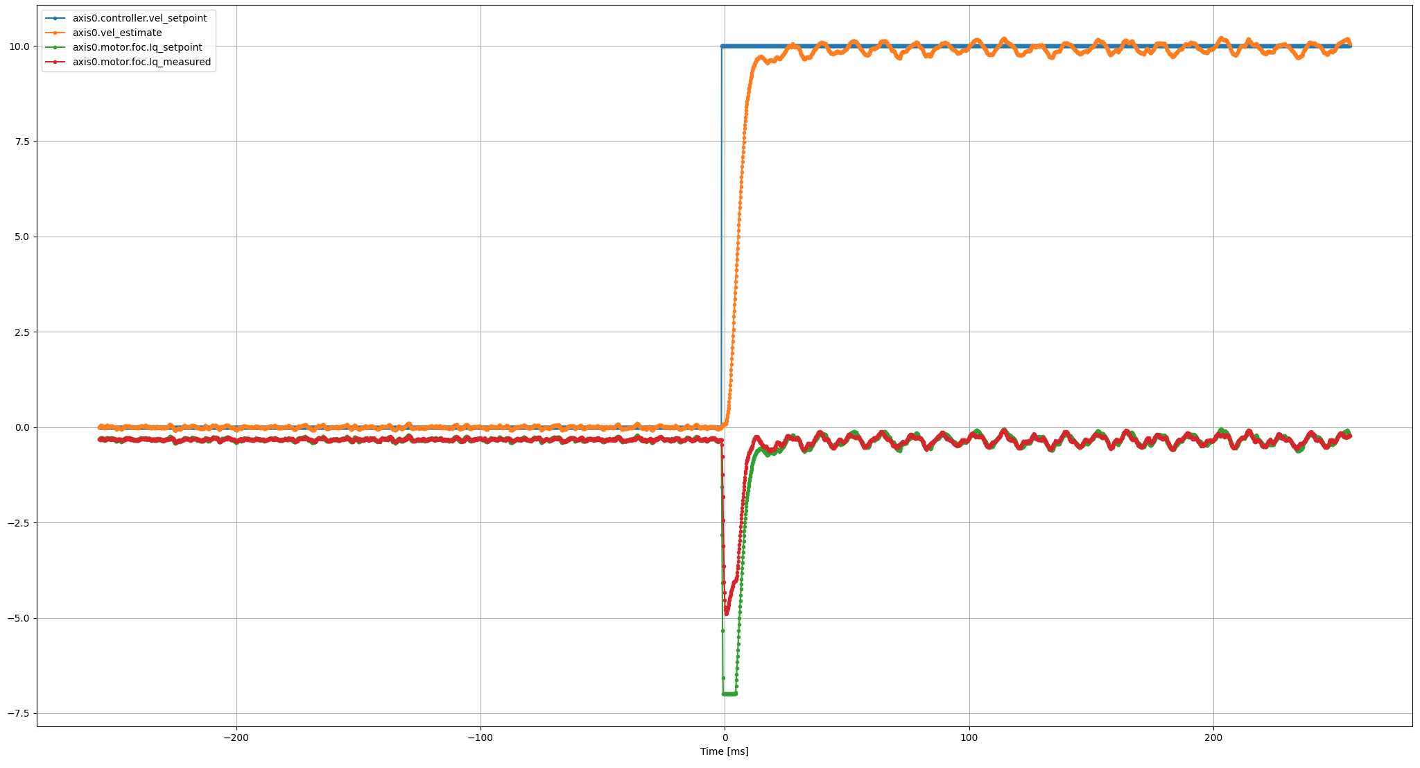

Assume we want to see how the axis responds to a step in input velocity. Assume the ODrive is already configured for basic velocity control.
Enter
CLOSED_LOOP_CONTROLmode.
odrivetoolodrv0.axis0.requested_state = AxisState.CLOSED_LOOP_CONTROL
Send an input step while running a high rate recording.
The input step (
odrv0.axis0.controller.input_vel = 10.0) and the triggering (trigger_and_download_sync()) must happen in quick succession, otherwise the capture window might not contain the time frame that’s of interest anymore. To ensure this, paste the following snippet as a single block intoodrivetooland press enter.odrivetoolodrv0.axis0.controller.input_vel = 0.0 capturer = high_rate_capture_start(odrv0, ['axis0.controller.vel_setpoint', 'axis0.vel_estimate', 'axis0.motor.foc.Iq_setpoint', 'axis0.motor.foc.Iq_measured']) time.sleep(0.5) odrv0.axis0.controller.input_vel = 10.0 data = capturer.trigger_and_download_sync(return_as=np.recarray, t_fmt=TimestampFmt.NANOSECONDS)
Plot the result.
odrivetoolimport matplotlib.pyplot as plt for key in list(data.dtype.fields.keys())[1:]: plt.plot(data['timestamps'] / 1e6, data[key], '.-', label=key) plt.xlabel('Time [ms]') plt.legend() plt.grid() plt.show()
High rate capture of a velocity step response. Click to enlarge.
Close-up of the high rate capture. The time 0ms corresponds to the call to
trigger_and_download_sync(), so it is
shortly after the input step.
