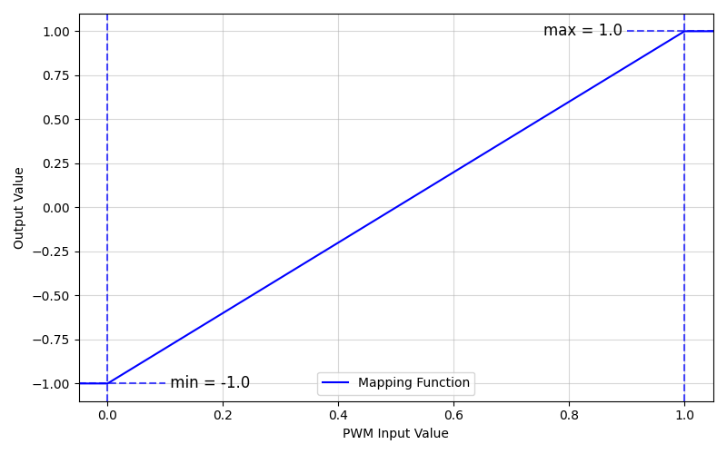

  4. Configure how the input value (0.0 … 1.0) should map to the output value by setting <odrv>.config.gpio(N)_pwm_mapping.min and <odrv>.config.gpio(N)_pwm_mapping.max.
../_images/pwmmapping.png
Example PWM input mapping where min = -1.0 and max = 1.0
Note
The max value can be less than min, allowing you to invert the output value slope relative to the PWM input slope.

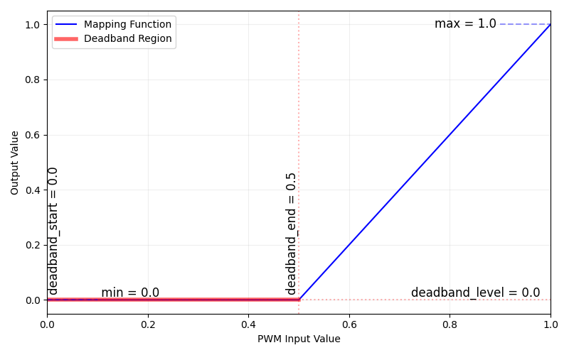

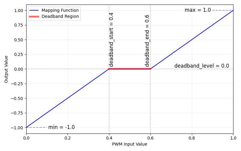

Deadband
⇒ New in Firmware 0.6.12
Optionally, a deadband can be configured using the following additional parameters in <odrv>.config.gpio(N)_pwm_mapping:
Config
Allowed Values
Default
deadband_enable
True, False
False
deadband_start
0.0 … deadband_end
0.0
deadband_end
deadband_start … 1.0
1.0
deadband_level
any
0.0
../_images/pwmmapping_deadband.png
Example PWM input mapping with deadband enabled

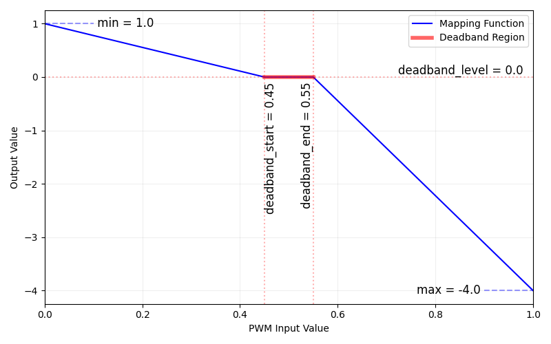

../_images/pwmmapping_asymmetrical.png
Deadband used to create asymmetric PWM slopes.
Useful for instance in a mobile robot that requires more fine-grained control when moving forwards than when braking. This example also demonstrates the ability to have the min value greater than max, inverting the output slope relative to the PWM input.
